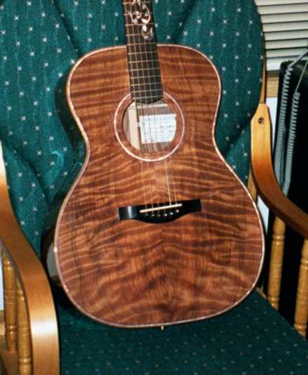

Here's an acoustic flamed redwood top that is pretty "busy" with flame......
Do make the footprint of your bridge plate bigger, especially below the bridge toward the bottom end of the instrument to help dissipate the stresses over a wider area. The top pictured ended up at about .130-135" thick and has held up quite well since built in 1999, but the owner is zealous about maintaining humidity in the case. I would not recommend a flamed redwood top for "the road"....too many climatic variables happening too fast, not to mention the normal wear and tear the "road" can generate.

[QUOTE=HankMauel] Here's an acoustic flamed redwood top that is pretty "busy" with flame......
Shazaam--that's beautiful Hank!
